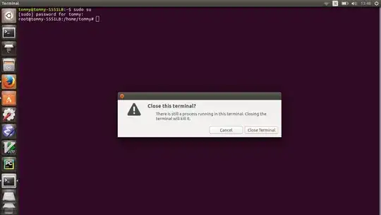

I found myself using a terminal a lot, but there is something which kinda bugs me: even if no command is running, if I'm logged in as root (I mean after typing sudo su and then my password) when I want to close the terminal it will prompt me with this
How can I close it without that message popping up? I want it to pop up only if the terminal is executing some command.

Something is running. su is running. You can verify if you have a clean terminal with everything closed by typing exit at the prompt.
If you exit out of su, then you can close it without getting the process running on this terminal, prompt.
If a process is running, just keep executing exit until all the processes are closed.
