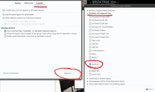

  1. Menu
  2. Preferences » System Settings
  3. Keyboard (under Hardware)
  4. Layouts tab
  5. Options... (bottom right)
  6. Expand Position of Compose Key
  7. Check Right Alt (or other key if you prefer)
Position of Compose Key Screenshot
