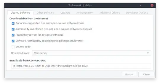

NOTE
Make sure you have selected the "Main Server" for downloading software and updates in the "Software and Updates" settings. I've included the screenshot below so you can see what it looks like. I'm not on Ubuntu right now so I'm not sure how to get there, but it shouldn't be so hard to find.
