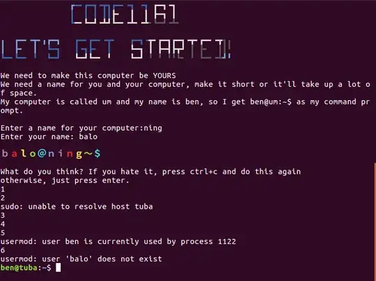

I am distributing a VM to my students for a beginners programming course. For speed, instead of getting them to install Ubuntu from scratch, I'm planning to give them a fully set up image that they can just run.
In order to get it set up I've given it a sacrificial hostname, username and password. What's the cleanest way to change this for the students when they get up and running?
I've got as far as this gist, which has some unreliable progress with the hostname, but the username is resisting me changing it.
I'd like it to be as painless a process as possible as this is supposed to happen in their first lab.
It's entirely possible that there is a completely different approach that I ought to take. I'm open to all suggestions.

a screen shot of the output progress

Let's look at man usermod to get an explanation for what's going on:
CAVEATS
   You must make certain that the named user is not executing any
   processes when this command is being executed if the user's numerical
   user ID, the user's name, or the user's home directory is being
   changed.  usermod checks this on Linux, but only check if the user is
   logged in according to utmp on other architectures.
Basically, this just means we can't change a user's UID, their username, home directory, or anything of the sort if the user is logged in.
So, we can do some fun stuff to set this up on the system's next boot. Instead of your script doing the work, we make your script make another script to do all the heavy lifting and manipulation. An example of this:
# Make the first-run script
touch /etc/init.d/firstrun-setup.sh
# Add in user modifier
echo "usermod -d /home/$username -m -g $username -l $username ben" >> /etc/init.d/firstrun-setup.sh
# Add in group rename
echo "groupmod -n $username ben" >> /etc/init.d/firstrun-setup.sh
# Add in password expiry
echo "passwd -e $username" >> /etc/init.d/firstrun-setup.sh
# Add in file self-destruct
echo "rm /etc/init.d/firstrun-setup.sh" >> /etc/init.d/firstrun-setup.sh
# Mark the file as executable
chmod a+x /etc/init.d/firstrun-setup.sh
# Reboot the computer
reboot
Basically, by doing this, you're "queueing" events to run on the system's next boot. This will run before the userland happens, so the system will execute these commands as root. Therefore, the ben user won't be logged in, and the system won't complain.
You may still need to add additional commands to this thing to allow more personalization (like setting the actual name, etc). However, this is optional and only needs to be done if you want it to take place during the setup script.
Though, it may be a good idea to just create a new user for the students entirely, and then keep your existing sacrificial account in place. This way, if something happens, you can go in and repair/administrate their machine if at all necessary. Of course, if you're giving your students admin access to their VM, this is sort of a moot point as they might very well delete the "instructor" user because they're students.

At the login screen, have them press ctrlaltF2 and login as ben from the terminal that opens and run
sudo passwd
And give them all the same password for root, ie, the course number, so if something breaks, you can go in and fix it. Then have them log out by typing exit, and log in as root with their new root password and run the script (you may have to modify it so it alters the ben user and not root).
Or, have them log in as ben from the terminal by pressing ctrlaltF2 (like before) at the login screen and have them then run the script from there. This could work because as Muru and Kaz Wolfe pointed out in the previous answer, the user cannot be running any processes, and logging in via the terminal shouldn't start any processes, such as X or Ubuntu-Desktop, or other userland processes that interfere with usermod. (I don't know if this works, I haven't tried it, but it's worth a try).
