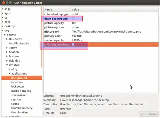

Yes, in Gnome 3, Gconf is being replaced by DConf, which is accessed through GSettings. You can use dconf-editor from the dconf-tools package to explore. It's very similar to gconf-editor.
The entries your looking for are located at org -> gnome -> desktop -> background
Uncheck draw-background AND show-desktop-icons
No more openbox menu and wallpaper problems :)
The setting mentioned in Jo-Erlend Schinstad's answer has been deprecated and I can't find a new equivalent setting. A workaround is to let the file manager set the background but set the alpha to zero. The command for this is
dconf write /org/gnome/desktop/background/picture-opacity 0
or you can use the dconf-editor gui to set it as discussed in Jo-Erlend Schinstad's answer.
The setting to hide the desktop icons is still the same:
dconf write /org/gnome/desktop/background/show-desktop-icons false
