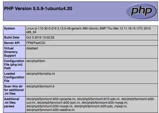

Now this is because PHP 5 doesn't work with mpm_worker so, I followed this How to configure Apache to run PHP as FastCGI on Ubuntu 12.04 via terminal? and now I am running fastcgi as shown in phpinfo().
phpinfo
Everything looks fine but again, when I am disabling mpm_prefork and enabling mpm_worker, I am getting this error:
Apache is running a threaded MPM, but your PHP Module is not compiled to be threadsafe.  You need to recompile PHP.
So I have have to go to default mpm_prefork module to keep the site running. I am not sure what else to be done, any help ?
