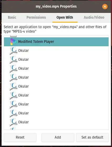

Based on e2-e4's Solution, here is a way how you
can also add the modified player to the menu entry
and set it as your default media player:

Step 5) Set modified totem media player as default (Reference):
…/totem-XYZ$ cd ~/
~$ wget -c https://upload.wikimedia.org/wikipedia/commons/c/c3/GNOME_Video_icon_2019.svg?download -O totem-logo.svg # get icon
~$ sudo mv totem-logo.svg /usr/share/pixmaps/ # move icon
~$ cat << EOT >> totem_media_player.desktop
[Desktop Entry]
Type=Application
Name=Modified Totem Player
Comment=A free media player for the GNOME desktop environment.
Icon=/usr/share/pixmaps/totem-logo.svg
Exec="/usr/local/bin/totem/totem-3.34.1/obj-x86_64-linux-gnu/src/totem" %f
Terminal=false
Categories=AudioVideo
EOT
~$ desktop-file-validate totem_media_player.desktop           # validate file
~$ mv totem_media_player.desktop ~/.local/share/applications  # move file
~$ update-desktop-database ~/.local/share/applications        # update menu entries
Step 6) Right click on a .mp4 video file and change default application:
Step 7) Done.
