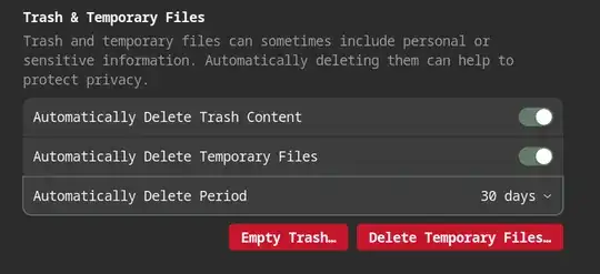

Assuming you have your trash setup to auto-expire after N days, I have also just symlinked ~/Downloads to my trash, eg:
mv ~/Downloads/* ~/.local/share/Trash/files/
rm -rf ~/Downloads
ln -sf ~/.local/share/Trash/files ~/Downloads
Then you don't have to reconfigure the download dir in any apps, eg. browsers.
Just check Gnome privacy settings to configure the auto-delete thresh:
set trash to expire after N days
