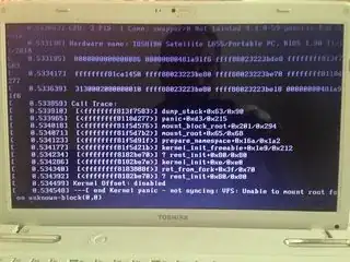

I just booted up my ubuntu partition, it was working and I've installed the updates via the software updater but it crashed at the end, so I've restarted the pc and now I'm getting this:
I guess it's a kernel panic related to the hard drive. How can I fix this, I need to copy my SSH keys at least.
PS: I have windows 7 also installed on a different partition and it works fine.

The first thing is to perform a file system check on your Ubuntu disk...
  • boot to the GRUB menu (where you select which OS to start)
  • choose Advanced Options
  • choose Recovery mode
  • choose Root access
  • at the # prompt, type sudo fsck -f /
  • repeat the fsck command if there were errors
If you can't do the above, then....
  • boot to the Ubuntu Live DVD
  • start gparted and determine which is your Ubuntu partition
  • open terminal and type sudo fsck -f /dev/sdaX changing the X to the appropriate number of your Ubuntu partition
  • repeat the fsck if there are errors
Now we use the SMART internal disk monitoring tools to see if it detects a pending hard disk failure...
  • start the Disks application from the Unity dash
  • select the hard disk in the left pane
  • click on the "hamburger" icon in the top-right of the Disks window
  • select SMART Data & Tests
  • view the data, and run the tests
Then try to recover from the failed installs (this only applies if you're coming from step #1)...
  • type sudo mount -o rw,remount / # to remount root as read/write
  • type sudo dpkg --configure -a # to fix broken dpkg
  • type sudo apt-get install -f # to finish upgrades
  • type reboot
