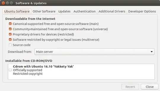

First make sure that all repositories are enabled, open Software & Updates and mark all sources :
software
Now open a terminal and execute the following commands to install all the packages needed :
