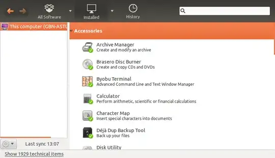

For a graphical view, open the Software Centre, and click on the Installed button at the top:
You may want to click the Show X technical items button if you're interested in system stuff, but Chromium would be there on the list anyway.
