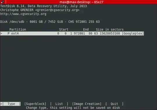

Reading through forums and blogs, I understood that Testdisk+Photorec might be able help recover the lost partition. I gave Photorec a quick try but since most of the important files are binary and have no file signature I ended up having thousands of useless .txt files and non-readable .mat files. Testdisk on the other hand, displays inconclusive prompts as far as I understand. I did not yet attempt to perform a deep scan, as I expect the information to be at the very beginning of the drive (the drive is 8TB). See the following Testdisk snapshots for more info:
Partition selection screen
Advanced menu after selecting None as partition type
  • Selecting EFI-GPT or Intel as partition type results in Testdisk telling me that there are no partitions available.
Analysis of the drive (after selecting None-type) results in the partition that is empty (except for an empty lost+found). In contrast, analyzing the drive after selecting the GPT-type results in many identical entries of this type: ext4 0 0 1 972801 80 63 156280533168
