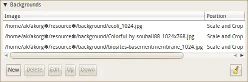

You can get the Wallpaper plugin for Compiz by installing compiz-fusion-plugins-extra (sudo apt-get install compiz-fusion-plugins-extra). It will show up under the Utility category in CompizConfig Settings Manager. enter image description here
Before you can use it, you'll have to configure Nautilus to not draw the desktop. Run gconf-editor and uncheck the setting /apps/nautilus/preferences/show_desktop. This will make all of your desktop icons disappear, and there is no solution to this drawback at this time.
To configure the Wallpaper plugin, add images to the list of backgrounds. They will be assigned to workspaces in the order they are listed.
