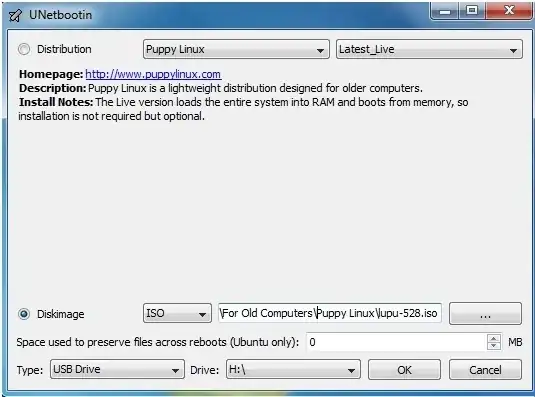

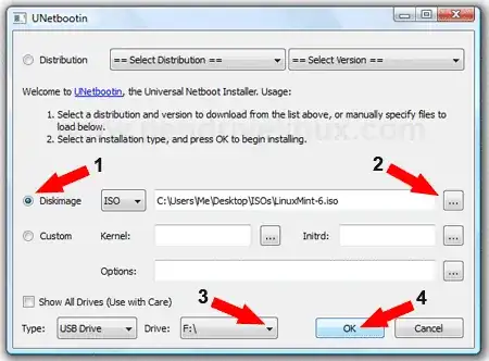

1) Unetbootin for creating live puppy..
Open unetbootin ..and select puppy linux.. after that ..select the downloaded os location and usb location.
Helping Screenshot:

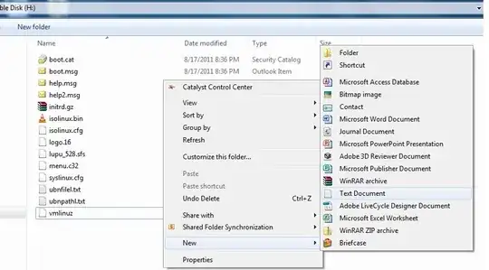

when completed , close unetbootin, then open the newly created bootable usb drive , here create a new text document and rename it to USBFLASH.
Helping Screenshot:
Note:when renaming clear the whole name including .txt

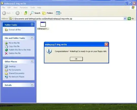

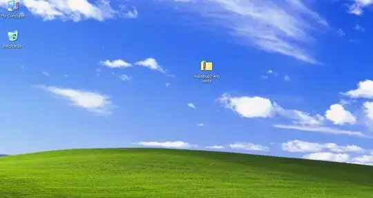

2) Create bootable floppy-drive
1) First format the floppy drive, go to computer and right click on the floppy drive icon and select format.
2) Extract wakepup2-img-write.zip

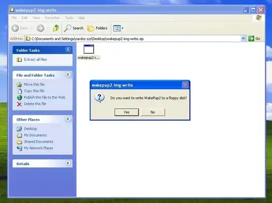

3) Open extracted folder and double click it.. it will automatically detect and install wakepup2 in the floppy drive.
Helping Screenshot:
That’s it ..now restart & make sure that floppy disk and usb drive is properly inserted…

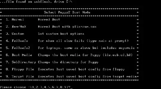

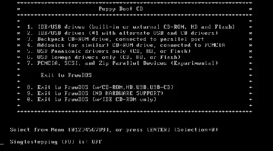

1) First Puppy Boot CD menu will prompted
Select menu by entering one of the given number . Don't press enter cause it will take you to option 8 (which is you don't want)
most probable by looking at the menu is option 1
if option 1 doesn't work for you .. try 2 , 7(scsi most common controller), maybe 8 too..
Option 1 or 7 both worked out for me
but check other options other than 1,7 if didn't work out for you..

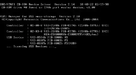

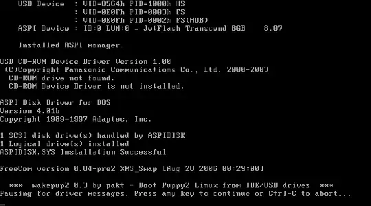

2) Now it will scan for usb devices
3) scanning completed after founding jetflash usb drive and installed managing software.Hit enter

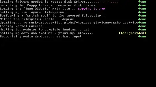

5) Copying Puppy to RAM ..

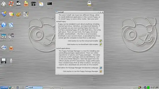

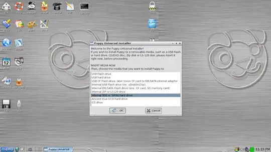

6) Here is lucid Puppy UI ...click the install icon on the desktop..
select universal installer..
Note:- Now you can install anywhere you want according to your hardware support..i.e internal hard drive(support for ide,sata and scsi controllers),usb drive & external usb hard drive, cd drive...
In this case you should select internal hard drive or may be old scsi hard drive.

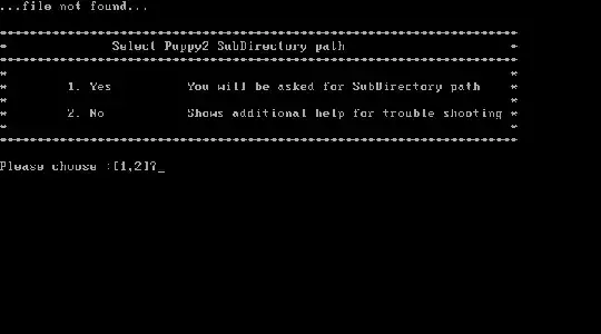

Common error when your device is not located(or installed)
ignore the message, restart and choose different option from the Boot Menu.
