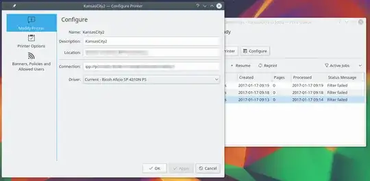

I have a Ricoh Aficio SP 4310N printer, with the matching driver selected as in the screenshots below. The only option I have under "Printer Options" is to query the printer for the default options. However, when I click that, I job gets sent with the name "Set Default Options", which fails with status "Filter failed".
