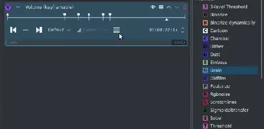

Another way to mute a part of the clip without cutting is using the Volume(keyframable) effect. Found at: Timeline->Add effect->Audio correction->Volume(keyframable)
This way allows to adjust the timing of mute regions.
  1. Add the clip to timeline
  2. Select the clip in timeline and add Volume(keyframable) effect
  3. Change interpolation of the existing key to discreet. The default key interpolation for this effect is linear. We can change the default to discrete to more easily manage the muted regions. Set Default Interpolation for Keys
  4. Add a new discrete key where the muted region should start and set the gain to minimum.
  5. Add another discrete key where muted region should end and restore the gain to 0.
You can add multiple muted regions this way and easily manipulate them.
