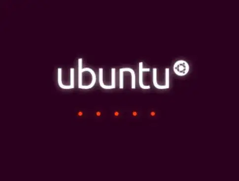

There were updates offered by Ubuntu and I installed them. After that the Ubuntu desktop GUI hasn't been working correctly and it freezes frequently. Moreover, instead of having the Ubuntu startup screen like below, only a blank gray screen comes, then on the desktop instead of wallpaper, only a black background is applied.

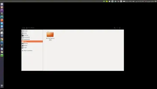

here is another screenshot of the Ubuntu desktop right now, enter image description here
