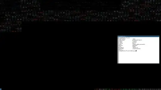

Now if I log in using LightDM I get the following screen:
Which is zoomed out (tiny status line fonts) and has odd red/green/blue pixels at the top of the screen (this changes with every boot sometimes the screen is all white with lots of colored blocks of pixels).

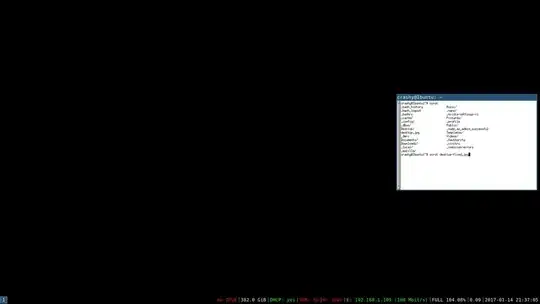

I can then reboot and run CTRL+ALT+F1 from the LightDM login to access a terminal and run startx this then renders with the following screen:
This has resolved the above issues there are no colored squares and the status line fonts are a proper size.
