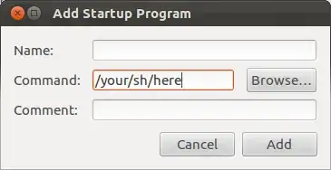

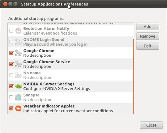

Dash-->Startup Applications-->Add-->/path/to/your/.sh

In the startup applications list add command below
sh <path to your file>.sh
make sure the file is marked as executable. i recommend to keep the file in home folder.
