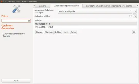

EDIT: Well my question is basically duplicated with these others, I keep to register what worked for me.
- Ubuntu 16.04 nvidia drivers don't work
- 14.04 nvidia dual display (external+laptop) stretched display, offset desktop
Finally editing the compiz settings worked for me:
