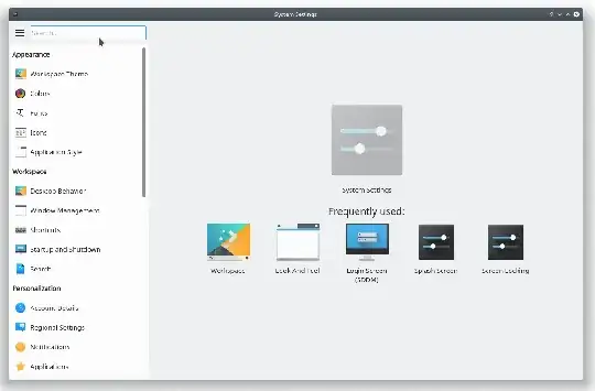

2) Change the theme from the KDE SDDM control module KDE System Settings > Startup and Shutdown > Login Screen (SDDM)
KDE Store
With the plasma 5.8 or older: Browse to the https://store.kde.org/browse/cat/101/ read the installation notes and download the wanted package. Install as told in the installation notes. Test as told in the https://github.com/sddm/sddm/wiki/Theming . Enable from the KDE SDDM control module.
With the plasma 5.9 or newer: Use the KDE SDDM control module.

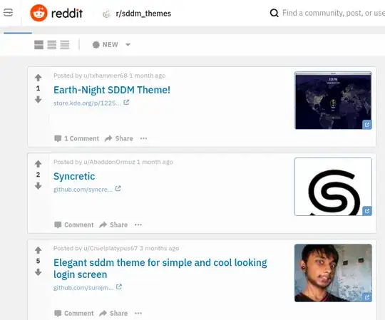

Other sources
i.e: https://www.reddit.com/r/sddm_themes/

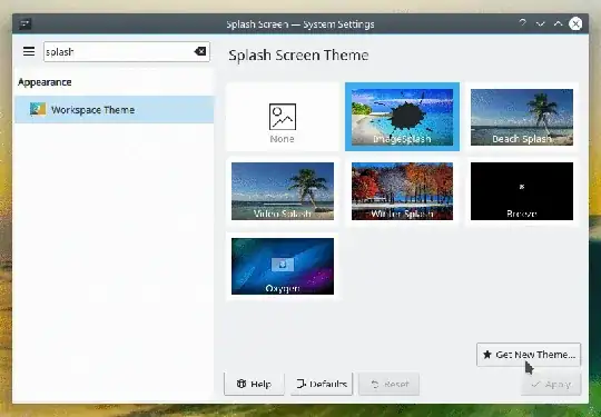

2 Alternative Plasma Splash screens
Plasma splash screen is a short qml script. The plasma splash is part of the plasma look and feel theme or with the plasma 5.13 it is possible to install the splash screens from the KDE System settings:
A bug report: Bug 358839 - Splash screen not easily customizable from the splash screen settings menu. - https://bugs.kde.org/show_bug.cgi?id=358839
and a fix: https://phabricator.kde.org/D11919
The plasma splash screens are downloaded from the KDE Store: https://store.kde.org/browse/cat/488/ord/latest/
