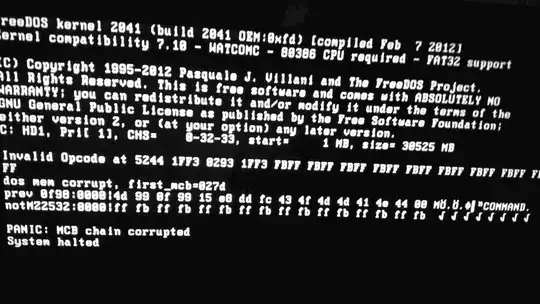

Then using Rufus under Windows 8.1 created a boot USB with FreeDOS as the OS and this much more detailed error appeared:
Camera 20170111

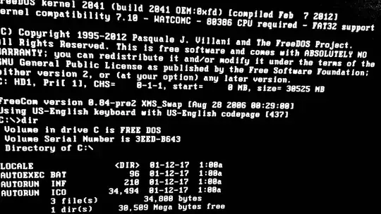

After googling many websites with Dell Inspiron USB Boot Error I found a link to these instructions (pendrivelinux.com - BIOS USB booting tips and tricks) which tells us to unplug all other USB devices:
  • Port 1 had extra power cable for charging USB devices next to laptop.
  • Port 2 had USB bootable flash drive that didn't work.
  • Port 3 had Logitech unifying receiver for K800 backlit keyboard and MX Pro mouse
  • Port 5 had 10 foot USB 3 cable to 7 port powered hub containing printer, UPS (Uninterruptable Power Supply) communications, cell phone and bluetooth headphone charging.
Unplugging everything except the USB Flash drive made USB boot successful:
DOS boot

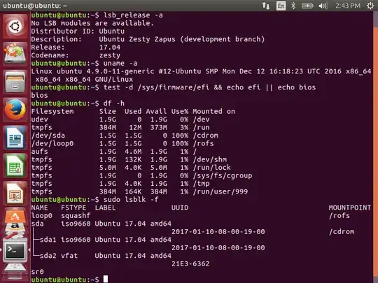

Replying to "Oh BTW still haven't got 17.04 live USB working yet on BIOS format on UEFI machine":
Yesterday (2017-01-10) I zsynced the daily Ubuntu Zesty amd64, cloned it with mkusb-dus (with dd under the hood).
  • It works live in my 3-4 year old Toshiba laptop in BIOS alias CSM mode (InsydeH2O rev. 3.7, System BIOS version 6.10 EC version 6.00). The screenshot illustrates this particular case:
  • It works in UEFI mode too in that computer.
  • It works in my newest computer, an Intel NUC6i3SYH in both BIOS and UEFI modes (Intel Visual BIOS SYSKLi35.86A.0024.2015.1027.2142)
I think what you see in gparted is caused by a bug in gparted. It does not understand hybrid iso files and the system they create in USB drives. But
sudo lsblk -fm
will show the partitions and ISO 9660 file system in a correct way.
So let us find out, if the problem is due to the iso file or the computer (your Dell). Cloning with dd is very reliable (when done correctly with or without help of a 'safety belt' shellscript).
sudodus
