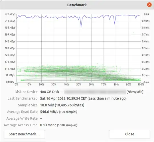

Graphical method
  1. Open the “Disks” application. (In older versions of Ubuntu, go to System -> Administration -> Disk Utility)
    • Alternatively, launch the Gnome disk utility from the command line by running gnome-disks
  2. Select your hard disk at left pane.
  3. Now click “Benchmark Disk...” menu item under the three dots menu button, in the pane to the right.
  4. A new window with charts opens. Click “Start Benchmark...”. (In older versions, you will find and two buttons: one is for “Start Read Only Benchmark” and another one is “Start Read/Write Benchmark”. When you click on anyone button it starts benchmarking of hard disk.)
Screenshot
How to benchmark disk I/O
