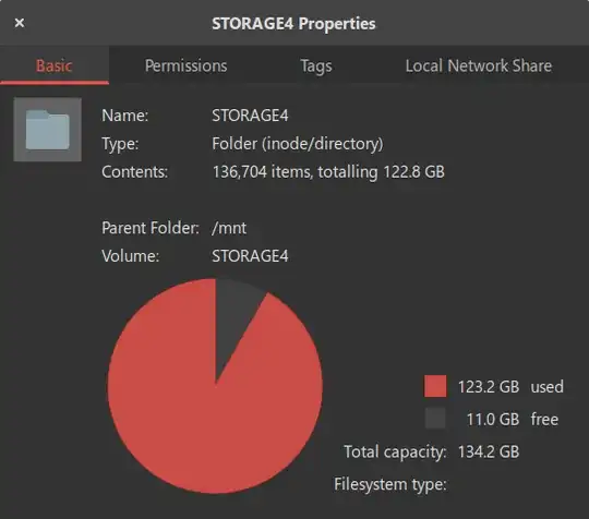

I installed 2 OS: Windows 10 in /dev/sda1 and Ubuntu 16.04 in /dev/sda5, I also make a NTSF drive (named STORAGE4, not Windows 10 partition, for saving data only) auto-mount at startup (using gnome-disks)

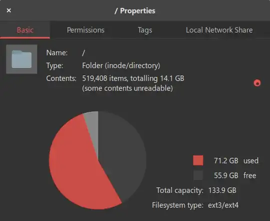

My root partition (/dev/sda5):
Filesystem type: ext4
Size: 133.9 GB total, 71.2 GB used, 55.9 GB free
My STORAGE4 (/dev/sda2):
Filesystem type: NTFS
Size: 134.2 GB, 123.2 GB used, 11.0 GB free

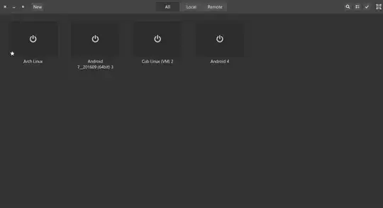

You also didn't mention if the Virtual Machines were set to start at boot
I have 4 virtual machines and they're all turned off. How can I even set these VM start at boot anyway? (I mean, before I even see the lightdm login screen)
