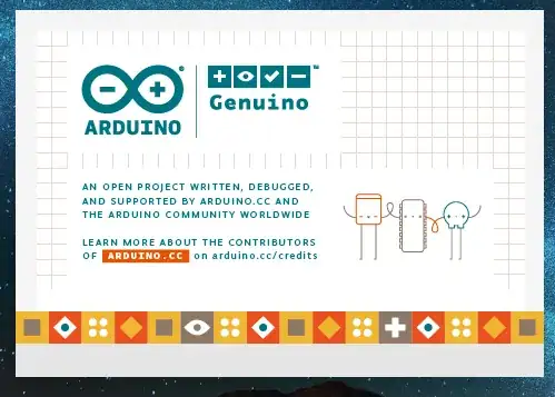

It created a desktop icon but when i try to start it.
it is just show this screen for seconds and do nothing : enter image description here

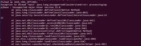

Update:
I tried to run it from terminal ./arduino it show that enter image description here
Tarek
  • 378
I searched for the error I found in terminal and find it may caused by old java version
and I upgrade java version by the way in this post
sudo apt-add-repository ppa:webupd8team/java
sudo apt-get update
sudo apt-get install oracle-java8-installer
