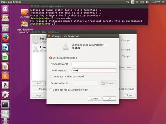

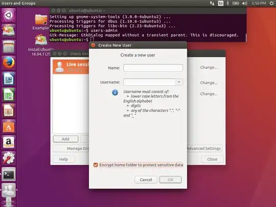

Yes it is possible to create a new user with encrypted home in a persistent live drive made with mkusb. I have done it so I know that it works. It is probably easiest if you install gnome-system-tools and use users-admin.
sudo apt install gnome-system-tools
users-admin
or start it via the graphical user interface.
Select Add to create a new user and select encrypt home folder. Otherwise the password is not really meaningful in this kind of system.
Warning: it is very important to backup the system regularly and to remember the password to the encrypted system. Otherwise you might lose your data. There is no back door.
If you keep the default user, the system will auto-login (unless you change that setting). Log out and select the new user ('tester' in the example below) and enter the password.

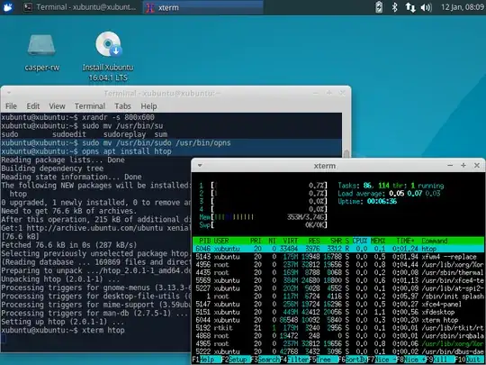

This is a quick fix, that is not adding security against a qualified attack, but maybe it would be enough to prevent tampering by curious persons, to make your persistent live tweaks in Xubuntu 'noob-proof': move (rename) sudo and remove the gui tools to manage programs, gnome-software, update-manager and maybe software-properties-gtk.
sudo mv /usr/bin/sudo /usr/bin/opns
opns apt remove gnome-software
opns apt remove update-manager
opns apt remove software-properties-gtk
Or better, move sudo to some other name, that is more difficult to guess. The following screenshot illustrates that it works to use the 'moved sudo' command to install a program package,
opns apt install htop
