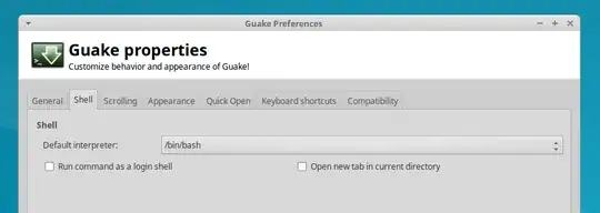

As "steeldriver" suggested, the problem is that the shell interpreter used by the embedded Guake terminal was not set up as "bash" (which is the one that is affected by .inputrc. As "AlexP" mentioned, Guake is simply displaying (emulating) a terminal, and changes to "bash" should be global across all emulators.
Thus, to enable history search in Guake, I simply had to change the shell used in Guake. This is done in Preferences, under the "Shell" tab:
