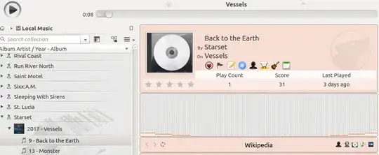

This is also shown in Amarok, which shows the group of songs' album cover, but not the picture for the song itself:
(album in lower left, song in center). Also, the files are purchased from the band's website, versus iTunes or Google Play, so that might be relevant. Thanks!
