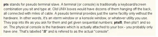

Every gui program--include virtual terminal in gui is the client(or say slave) of x-server(or say x window system) ,so it was called pesudo terminal slave.
Muru give me many new knowledge,maybe there is a wrong expression in muru's explaination. something about pts from other view
In my opinion,the proper sentence would be that:
but that's an application program in X server started from the tty1, but also a pts.
Please see the discuss here on what is pts/0 and (:0.0) in linux when typing who am i
quoting from an answer
From the knowledge,i draw my conclusion.
It not only an X server started from the tty1, but also a pts.

this gui is pts/0
Um, nope. I'm not sure where you got pts/0 from, but that's an X server started from the tty1, it isn't pts/0. See this U&L post for more.
