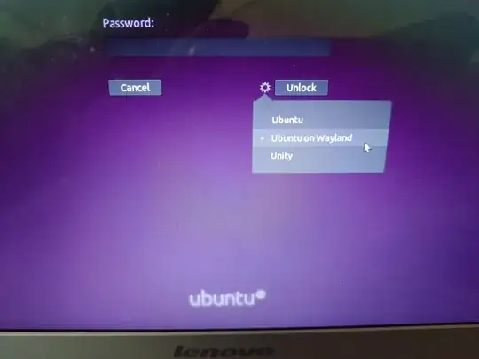

I found out that Ubuntu 18.04 gives an option of using Ubuntu on Wayland, which I learnt is an alternative to the x server. I logged in using the Ubuntu on Wayland option on the login screen:
the login screen
Now I can use the suspend option without any problem.
