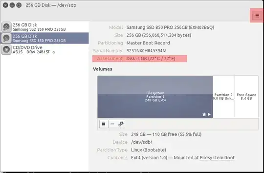

2.) Check your HDD for errors with the 'Disks' utility that comes with Ubuntu. The Live-CD has it already available.
Check the 'Assessment' first, which is a simple output of the last SMART values check. You may want to run a new check by pressing the options button in the top right and selecting "Smart DATA & Self test".
This will give you an initial indication of potential trouble. But SMART data isn't always indicative of all issues. You may also have to do a surface scan of the drive.
