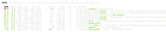

I've been having this happen for a while - not too sure what caused it.
There's one or two processes (here /usr/sbin/aptd) that always spike up to 98-100% CPU usage, and I'm not sure how to solve this.
Would someone mind clarifying what the issue is, and if uninstalling Python 2.7 (and dependencies, i.e. Python 3, etc.) would help?
Thanks.
