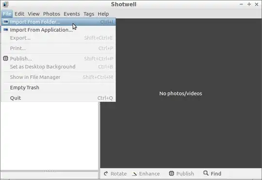

In Shotwell, in the File menu, click Import from Folder. Then select the folder you want to import images from. This won't be limited to .cr2 files, but if you're opening files from multiple subfolders containing .cr2 images created from a digital camera, then most likely those will be the only files present.
Screenshot of the Import from Folder menu item in the File menu of Shotwell.
See Jakob's answer to Show all pictures recursively (include any subfolders) for more information.

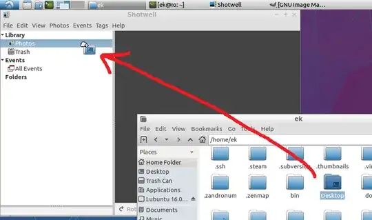

With most desktop environments and file browsers, you can also open Shotwell and drag the folder that contains your images into the Shotwell window. Like Import from Folder, this is another way Shotwell recommends to open photos.
Screenshot of me dragging my Desktop folder into Shotwell to import the images it contains.
When you drag from a file browser window or your desktop into Shotwell, you can drag to a specific library. Or if you don't have multiple libraries set up, you can just drag basically anywhere and it works. (You don't even have to drag into the left pane.)
This method is very convenient, and it is as powerful as manually selecting the folder (with File > Import from Folder, as described above). When you open files or folders using either of these methods, Shotwell gives you the option to open the photos without copying them into its library.

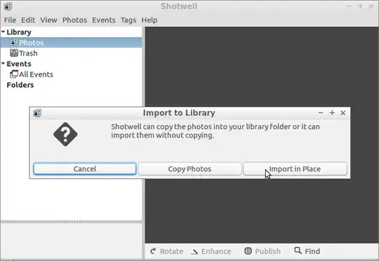

Screenshot of the dialog box in Shotwell that asks the user to choose between copying images to the location of their Shotwell library, or importing them in place, without any copying.
To import without copying, click Import in Place instead of Copy Photos.
