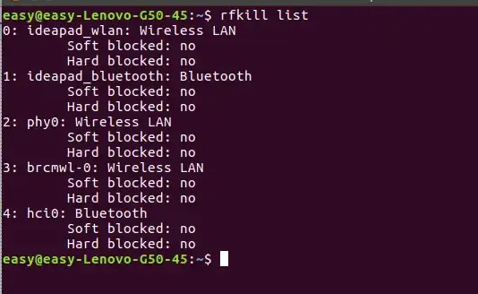

Here is the output of rfkill list in insecure mode:
screenshot
When I do rfkill list in secure mode, it doesn't show 2nd and 3rd one (both Wireless LAN).

Secure boot requires that all software and any added kernel modules, also commonly known as drivers, have a known, registered signing key in order to load. The Broadcom STA driver that your wireless devices requires doesn't yet have a signing key. You can either just disable secure boot or tell Ubuntu to disable secure boot in Ubuntu only using mokutil. Here are some details: Why do I get "Required key not available" when install 3rd party kernel modules or after a kernel upgrade?
As a 15-year user of Linux and Ubuntu, I am quite comfortable running a simple desktop machine behind a firewall-enabled router without secure boot.
