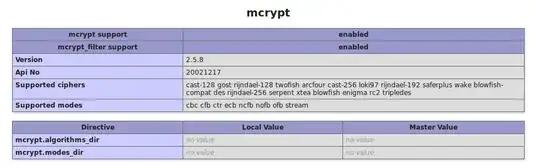

To confirm that mcrypt is enabled in apache follow these steps:
  1. Create a php file called info.php put this code in it:
    <?php echo phpinfo(); ?>
  2. Put the file in /var/www/html or your server root
  3. Access it from the brower at say IP/info.php or localhost/info.php
  4. Look at the out and you will find that mcrypt and mbstring are enabled
    As you can see, its enabled in apache, but inaccessible from php CLI hence the error messages.
  5. To confirm its working [as I have this problem also] I did the following:
    • installed prestashop application, and since one of the requirements of prestashop is php mcrypt it would have thrown an error and refused to proceed if mcrypt was not enabled on apache.
Simple put based on your the if your apache information page displays these modules as enabled then it is. The error seen are a result of php CLI having issues with mcrypt which has been noted to be a bug. Seen in earlier versions of php but now present in php 7
