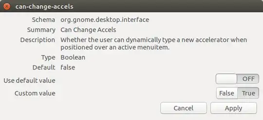

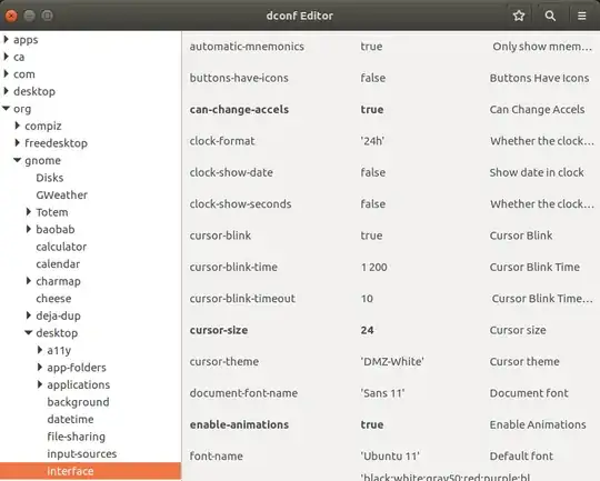

From the Gnome Help page I figured I had to use dconf-editor. Here are two screenshots showing my settings:

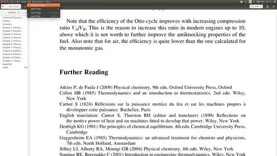

Now when I click "Go" menu in Evince, and move the mouse pointer down to menu item "Previous Page", I should be able to enter a new keyboard shortcut. But if I press Ctrl+Up and close Evince and reopens it, the shortcut does not work. Here is a screenshot from Evince:
