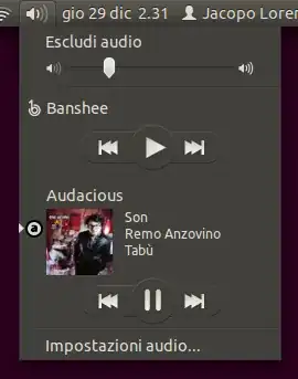

Right now, IT DOES! Audacious 3.2 supports the Sound Menu.
Screenshot of Audacious in the Sound Menu

You need to use Audacious 3.2 (currently in beta stage), that has the built-in support for the MPRIS 2 protocol needed for Sound Menu integration.
