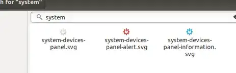

At least on 16.04 and 16.10, the icon is located:
/usr/share/icons/ubuntu-mono-dark/status/22/system-devices-panel.svg
As you can see, to test, I replaced it with an owncloud icon :)
Notes
  1. No need yo say that your new icons need to be of the same type (.svg)
  2. To edit/replace fioes in /usr you need administrator`s permissions. After backing up the old icons, simply run the command (from a terminal):
    sudo cp /path/to/new/icon.svg  /usr/share/icons/ubuntu-mono-dark/status/22/system-devices-panel.svg
  3. You might also want to replace:
    /usr/share/icons/ubuntu-mono-dark/status/22/system-devices-panel-alert.svg
    and
    /usr/share/icons/ubuntu-mono-dark/status/22/system-devices-panel-information.svg
    ...to make a matching set in case there would be a change in state for some reason.
