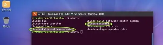

My recommendation is to literally use the Software Center. If you go to the terminal you will notice you have 2 Software Centers. The Kylin Chinese only ubuntu-kylin-software-center and the normal Ubuntu Software Center ubuntu-software.
So simply either open the Dash, look for Software Center and drag it to the main menu in Kylin or run it from the terminal.
