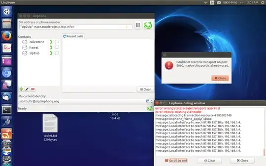

I've tried multiple clients on this machine, cannot get any SIP clients to work for me. On the same network, an Android tablet can call an IP phone, no problem, using free SIP accounts. Also, an IP phone, SPA 942, works fine with anveo. The hardphone worked fine with a free Anveo account, so I upgraded ($5/month or so?) to the paid service.
Why is linphone reporting that port 5060 is in use?
thufir@doge:~$

thufir@doge:~$ lsof -i -n -P | grep 5060
thufir@doge:~$
thufir@doge:~$ lsof -i :5060
thufir@doge:~$
screenshot:
port 5060 in use
the debug window:

message: TLS server method
warning: no system certificate loaded
error: eXosip: Couldn't read CA list
message: eXosip: Trusted CA folder : '/etc/ssl/certs'
message: getaddrinfo failure. 0.0.0.0:5060 (-9)
warning: Could not start tls transport on port 5060, maybe this port is already used.
message: Local interface to reach 87.98.157.38 is 192.168.1.4.
message: New local ip address is 192.168.1.4
message: Network state is now [UP]
message: Local interface to reach sip.linphone.org is 192.168.1.4.
error: wrong state: create transport layer first
message: allocating transaction resource 1 828422930
message: Sending a new SUBSCRIBE
error: eXosip: missing via header
message: allocating transaction resource 2 647562304
message: linphone_friend_apply() done.
message: allocating transaction resource 3 1353760134
message: allocating transaction resource 4 885502749
