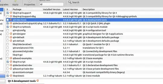

So I used Synaptic package tool to install Qt, now there are some of Qt things installed already and some are not. It specifically said to have qmake, I installed from Synaptic, again the same error as above.
qt in synaptic manager
How can I know which packages xconfig needs?
