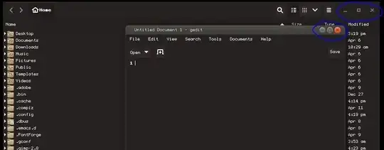

I took the numix-gtk-theme from Github, and began modifying it to make my own custom theme.
One thing that I've noticed, is that the custom theme only affects some of the Ubuntu windows. It seems that applications have their own window paneling, that I am unable to change.
For example:
Notice how gedit has the default Ubuntu buttons,
while the GNOME file manager is using my theme.
Is there a way I can get gedit and other applications to match my existing theme? I want all the windows to look the same.

You need manually change Metacity theme with GSettings:
gsettings set org.gnome.metacity theme THEME_NAME
