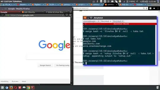

Fairly easy to accomplish with xargs and bash's nohup and & commands. The exact command is this:
xargs bash -c 'nohup firefox $@ &' null  < tabs.txt
With a tests file like this:
$ cat tabs.txt
google.com
askubuntu.com
unix.stackexchange.com
The way this works is simple:
  • redirect tabs.txt file as input stream to xargs.
  • xargs will treat all items coming in as arguments and pass them on to bash -c '' command. The null string is used just to set argument $0. It could literally be any string and is not relevant.
  • bash will run nohup firefox $@ & , while substituting all arguments in place of $@. The final result is that we get to open firefox, and disown it from bash's process via nohup and &
