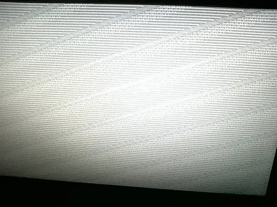

Now on running certain applications my screen goes pixelated;It gets completely scrambled and it takes on the colour of whatever was running and displays diagonal rows of pixels. The screen does not return and I am forced to reboot. I included the background info of the state of my computer before the reinstall so as to give an idea of the whole situation, in case that was what was causing the problem.

This problem never ocurred before i reinstalled ubuntu so did that change something? Could it be a nvidia/graphics issue again, or is it just my monitor with the problem? i have included an image here:enter image description here
Just to make it explicitly clear, my problem is the screen shown in the pic above , not the login loop issue.

one type of file that causes this is .odt.

Its been a long time since I logged in, and I decided to post how I fixed it just in case anyone else has the same issue. The issue was that Nvidia drivers could not be recognized. You will need to go to software and updates, in the additional drivers tab. Enable the required option for 3rd party Nvidia proprietary drivers.
From what a friend of mine told me, the issue is caused by the screen attempting a graphics overlay, such as the transparent overlay generated on clicking the Ubuntu dash home button. Im not sure how or why, but that always caused a problem. Opening Libre Office tools also resulted in the same issue.
