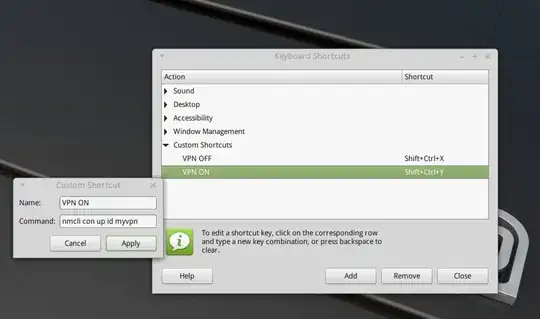

I just found the solution, very straight forward.
Simply creating two shortcuts, with the commands below:
for VPN ON: nmcli con up servername
for VPN OFF: nmcli con down servername
