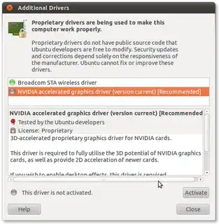

The recommended method is to use jocky
jocky
In your menu System -> Administration -> Additional Drivers
If you wish to go the manual route, and install the binary from Nvidia manually, there is a detailed walk through on this page Nvidia Manual. This involves manually compiling the driver and is not advised. Be warned, if you do this, you will need to re-compile the nvidia driver with each kernel upgrade.
