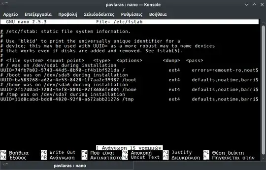

Don't create a swap partition on installation and if you already have, just boot a live session from USB stick and remove the swap partition using GParted or any other partition manager and do what you like with the extra hard disk space you just got. Then reboot (that will take time as it tries to mount a partition that's not there. Don't be scared; it will boot or I wouldn't be here writing it). When you boot open terminal and do:
sudo nano /etc/fstab
delete the line referencing the swap partition from the file, save and reboot.
Now you boot again fast, even faster than before since you boot a partition less. So we just increased our disk size, and we gained boot time.
