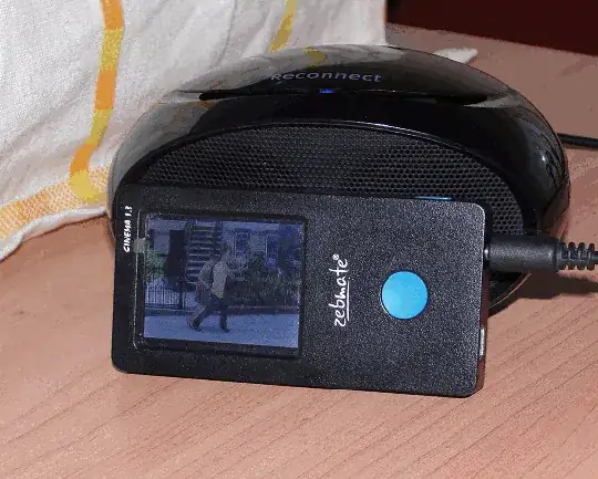

I made a fork of the amv-ffmpeg project because I have two players that now require AMV files. Here is how I convert files to AMV.
Using regular FFMPEG, I convert to a qqvga-size mono WMV file.
ffmpeg -i lucas.mp4 \
       -vcodec msmpeg4 -q:v 1 -s qqvga -r 16 \
       -acodec wmav2 -ac 1 -ar 22050 \
       lucas.wmv
Then, I use my forked amv-ffmpeg to convert the WMV to AMV.
amv-ffmpeg -i lucas.wmv lucas.amv
The quality, as you can see, is atrocious. Animation showing AMV file playing in a cheap Chinese MP4 player
To compile amv-ffmpeg, execute these commands.
git clone https://github.com/vsubhash/amv-ffmpeg.git
cd amv-ffmpeg
./configure
make
The amv-ffmpeg executable can then be found in a directory named bin inside the directory created by git. More information is available my blog.
