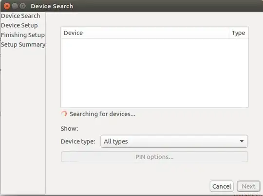

So, how can I fix this problem: "Bluetooth does not detect any devices. It just keeps searching and searching."
Here's a screenshot
It was recommended to me that I find another Windows driver for this adapter, which I do not know how to do.

This is a new device. Download this driver
Open it with Archive Manager, then extract folder
drivers/DP_Bluetooth_16123/Broadcom/FORCED/8110x64/12.0.1.1011
There you will see bcbtums.inf file and firmware hex files.
The firmware for your 04ca:2012 adapter is BCM43142A0_001.001.011.0311.0339.hex.
Convert it to BCM.hcd using hex2hcd and copy it to /lib/firmware/brcm.
Generally speaking you can find Windows drivers for new BT adapters by internet search. In your case I found this driver by vid_04ca&pid_2012.
