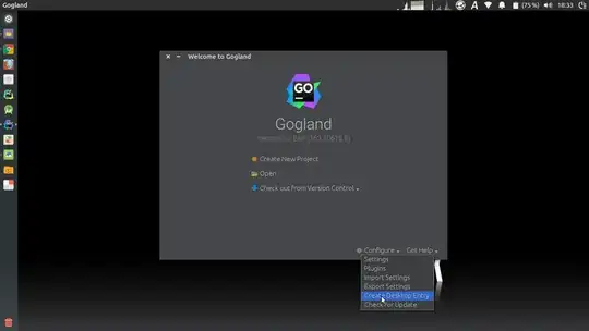

Anyway, Jetbrains IDE's usually comes with a builtin option to create launcher shortcut from its startup/initial screen. I think it's the best and simpler solution.
Builtin create shortcut

I don't have enough reputation to add a comment, so I'll create a new answer that is just an addition to the response from dgonzalez. With recent Jetbrains products, you can also go to the Tools menu and select 'Create Desktop Entry...' after that, you can load the product from the applications menu. You can also use the entry in that menu to pin the product to the panel.
